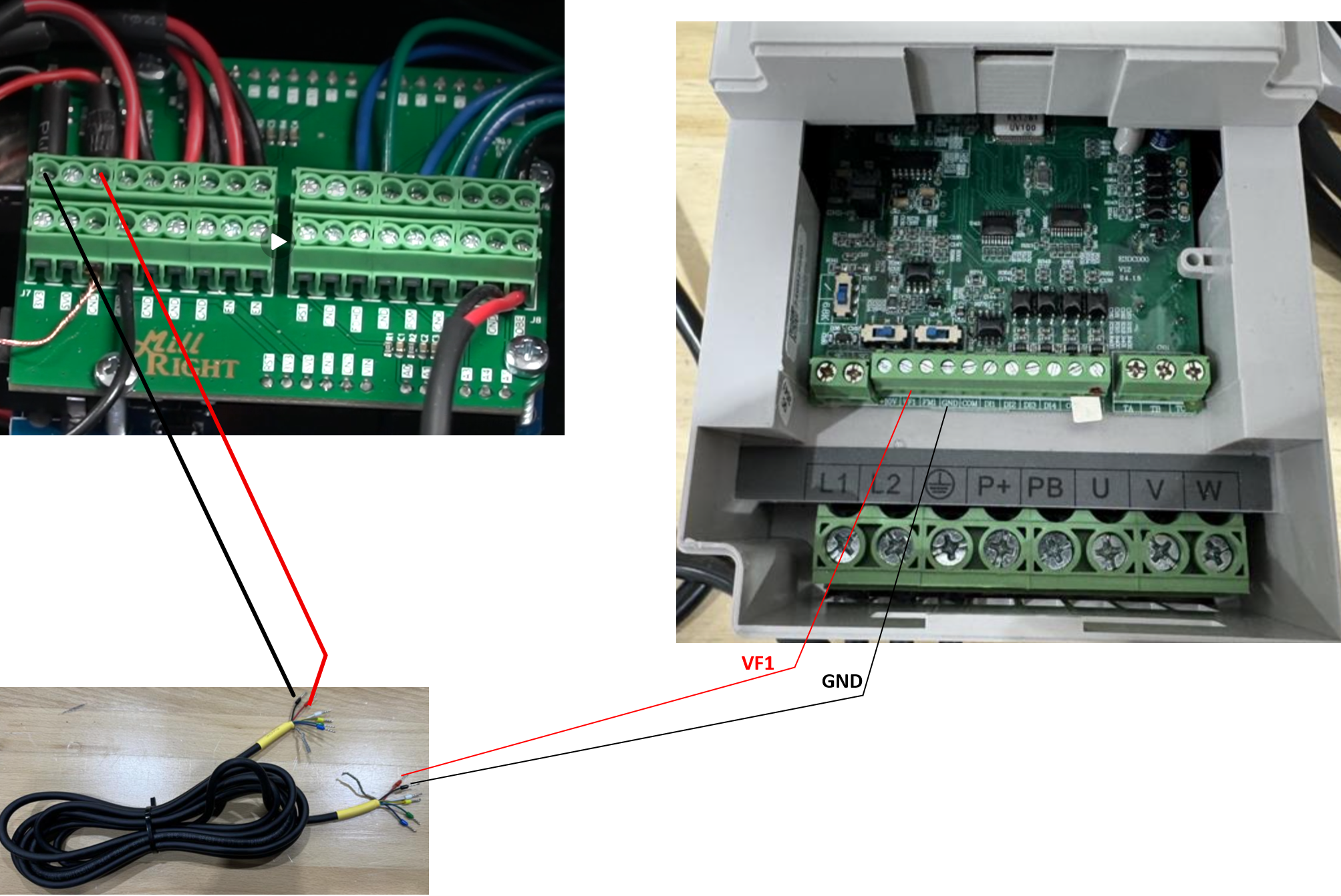

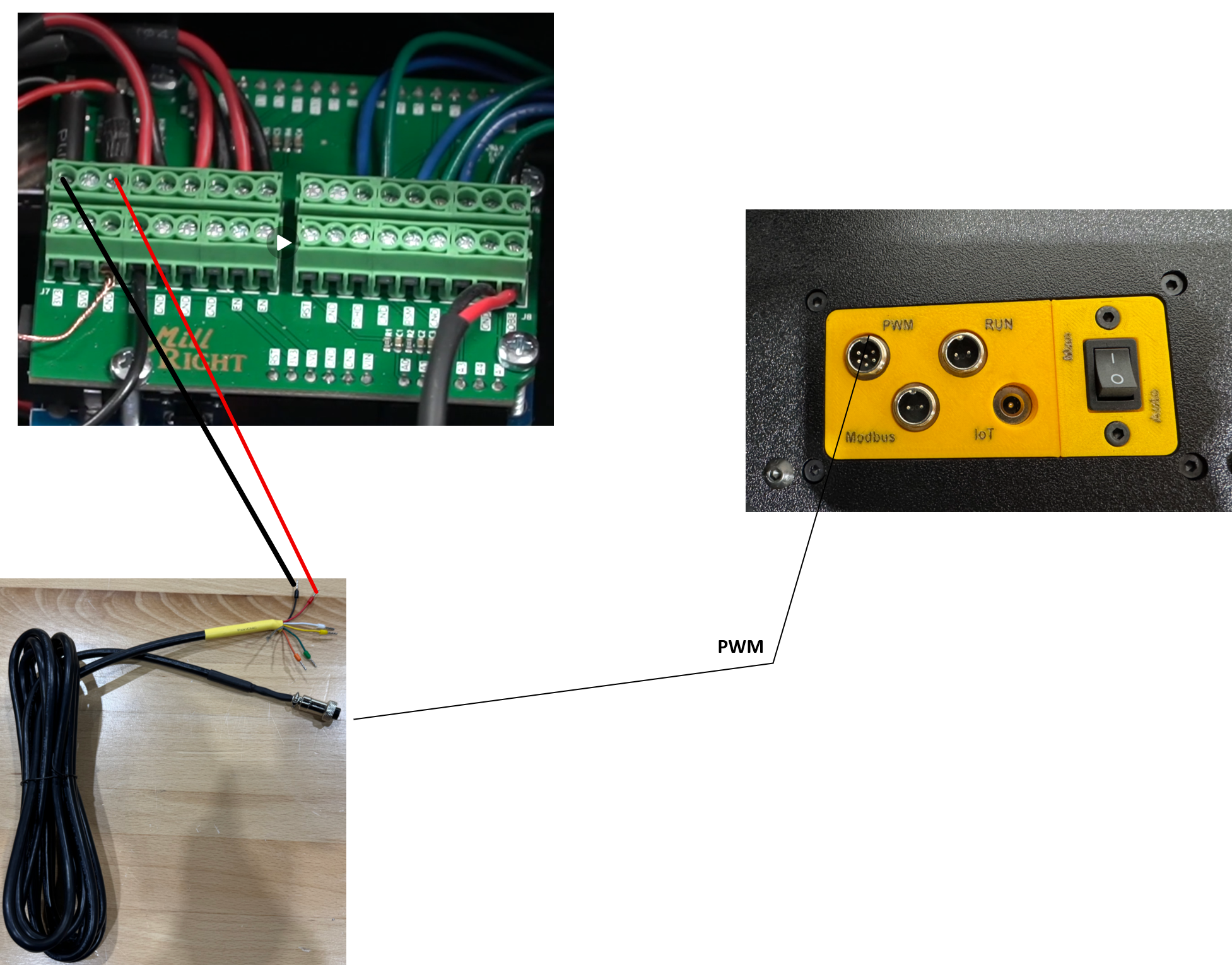

Wiring your Spindle to MillRight GRBL Controller for Automatic Mode Operation
Spindle System Wiring
Spindle Kit Wiring
This mode is where your CNC controller controls the VFD via a simple PWM variable voltage signal.  For MillRight GRBL this is 0-5v representing 0-24000rpms.
We have pre-programmed your VFD to run in automatic mode when the Manual Override switch is flipped to automatic (down or 0 position).  The vfd will monitor the PWM (red wire) and GND (black wire) for how fast the controller is instructing the VFD to spin the spindle motor.  You must still hit the "RUN" button on the VFD's keypad to change the vfd from standby/stopped mode (blinking keypad display) to spin/forward mode (solid keypad display).
P0.0.03 = 1
P0.0.04 = 3
P2.0.15=05.00
Your VFD will now monitor the PWM wires to know how fast it should spin the motor when in "Run Mode".
However you must still hit the "RUN" button on the VFD's keypad to change the vfd from standby/stopped mode (blinking keypad display) to spin/forward mode (solid keypad display).
