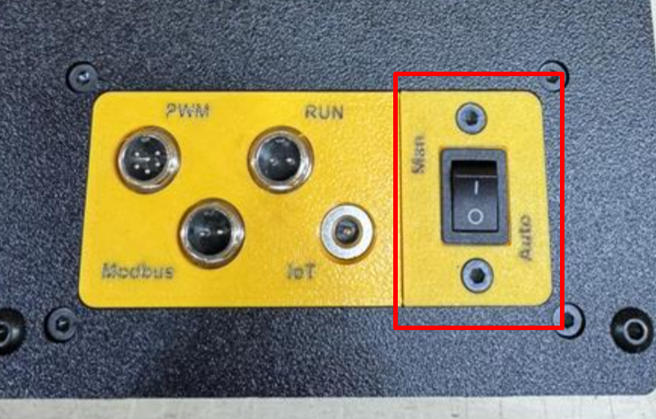

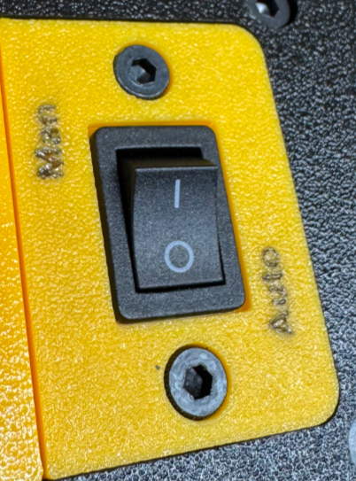

One of the advantages of the PwnCNC Spindle System is that it does not have to be locked into only manual mode or only automatic mode. Instead, the enclosed VFD includes a Manual Override Switch, also called the MOS, which allows you to switch between operating modes with a simple flip of a switch. This makes the spindle system more flexible than a spindle kit and gives you an easy way to run the spindle manually whenever needed. The MOS can be found on the left side of the VFD enclosure.

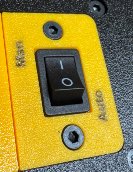

Unlike the spindle kit, the spindle system does not require reprogramming the VFD to move between manual and automatic operation. Instead, that change happens using the physical MOS switch built into the enclosure. Flipping the MOS upward / I / Manual allows RPM control from the VFD's keypad dial, while automatic control is used when the switch is not in that position.
Understanding the Manual Override Switch
The Manual Override Switch, or MOS, is located on the left side of the VFD enclosure.
For spindle systems:
  • Switch down, or 0 = Automatic Mode
  • Switch up, or 1 = Manual Mode
When the switch is in the up / 1 position, the spindle can be controlled directly from the VFD keypad. That means the RUN button starts the spindle, the STOP/RESET button stops it, and the dial adjusts spindle speed.
When the switch is in the down / 0 position, the system is set up for automatic control from the CNC controller instead.

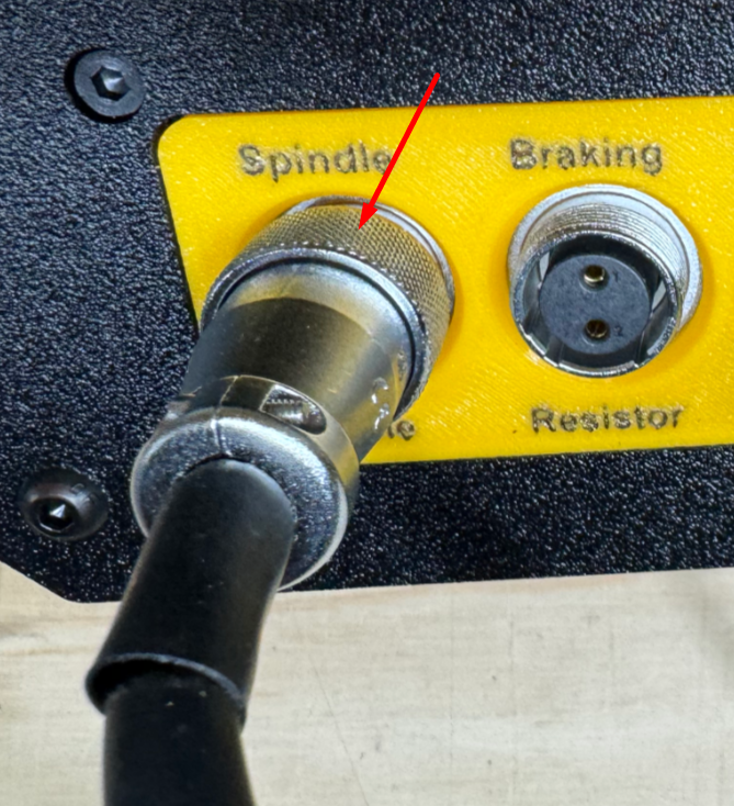

  • the spindle cable is connected to the spindle and the enclosure

The spindle cable should be installed before powering up, and we recommend installing and tightening a bit using the included wrenches.

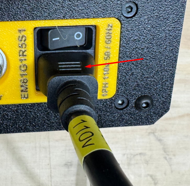

  1. Plug the enclosure power cord into the correct AC outlet for your system.
     (110v vs 220v:  https://support.pwncnc.com/kb/article/641-power-requirements-110v-220v/)

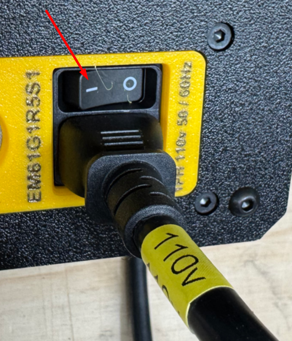

  2. Turn on the power switch at the enclosure power entry.
  3. Wait for the VFD keypad to light up.
Once powered, the keypad should display red numbers or letters. In standby, the display should be blinking. Blinking indicates that the VFD is powered on, but the spindle is not currently running. The spindle system manual describes this exact behavior during initial power-up.

Switching into manual mode
Before trying to run the spindle from the keypad, flip the Manual Override Switch into the up / 1 / Manual position.
This step is what gives the keypad control over the spindle.
With the MOS in manual mode:
  • the RUN button will start the spindle
  • the STOP/RESET button will stop the spindle
  • the dial will control speed
Without the MOS in the manual position, the keypad will not be acting as the primary control point.

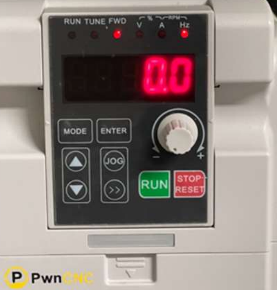

  1. Confirm the keypad display is blinking
  2. Confirm the MOS is in the up / 1 / Manual position
  3. Turn the speed dial all the way counterclockwise first
  4. Press the green RUN button
  5. The display should change from blinking to solid
  6. Slowly turn the dial clockwise to increase spindle speed
The green RUN button and the dial are the basic controls for manual operation. It also recommends starting from a low setting, then increasing speed gradually. The keypad's dial, or potentiometer, regulates frequency and that the FWD LED above the numbers is on when the inverter is in run status.

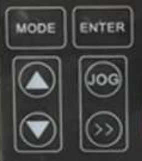

According to the keypad reference page, the top indicator lamps show operating status and display units. These include indicators for forward operation, run status, voltage, current, Hz, and RPM-related display values. The keypad also includes the RUN button , STOP/RESET button , the speed control dial , and the right-arrow style key used to scroll through monitoring values .
Blinking vs solid display
The simplest way to understand the display is:
  • Blinking display = powered on, stopped, standby mode
  • Solid display = spindle is actively running
What the numbers mean
When the VFD is blinking, it will most commonly be showing the current speed setting in Hz, which is the frequency the VFD will send to the spindle when started. The VFD’s base operation is frequency control in Hz, and that higher Hz means higher motor speed. It also notes that PwnCNC programmed the VFD so the display when running can show equivalent RPM values as well.
When the spindle is running, the display will typically show RPM, since that is more intuitive for most users. If needed, the double right arrow button can be pressed to cycle through available display values, including Hz or RPM while running.

  3. Flip the MOS to up / 1 / Manual
