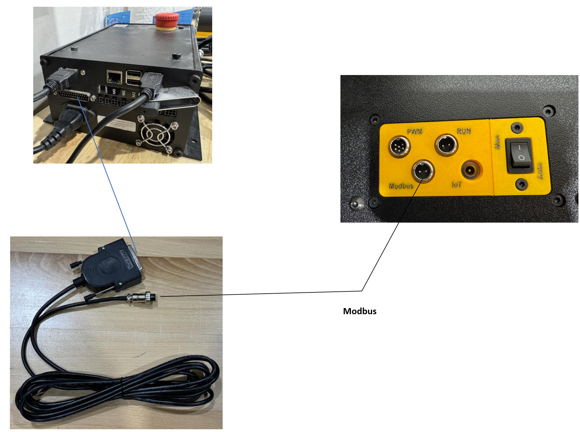

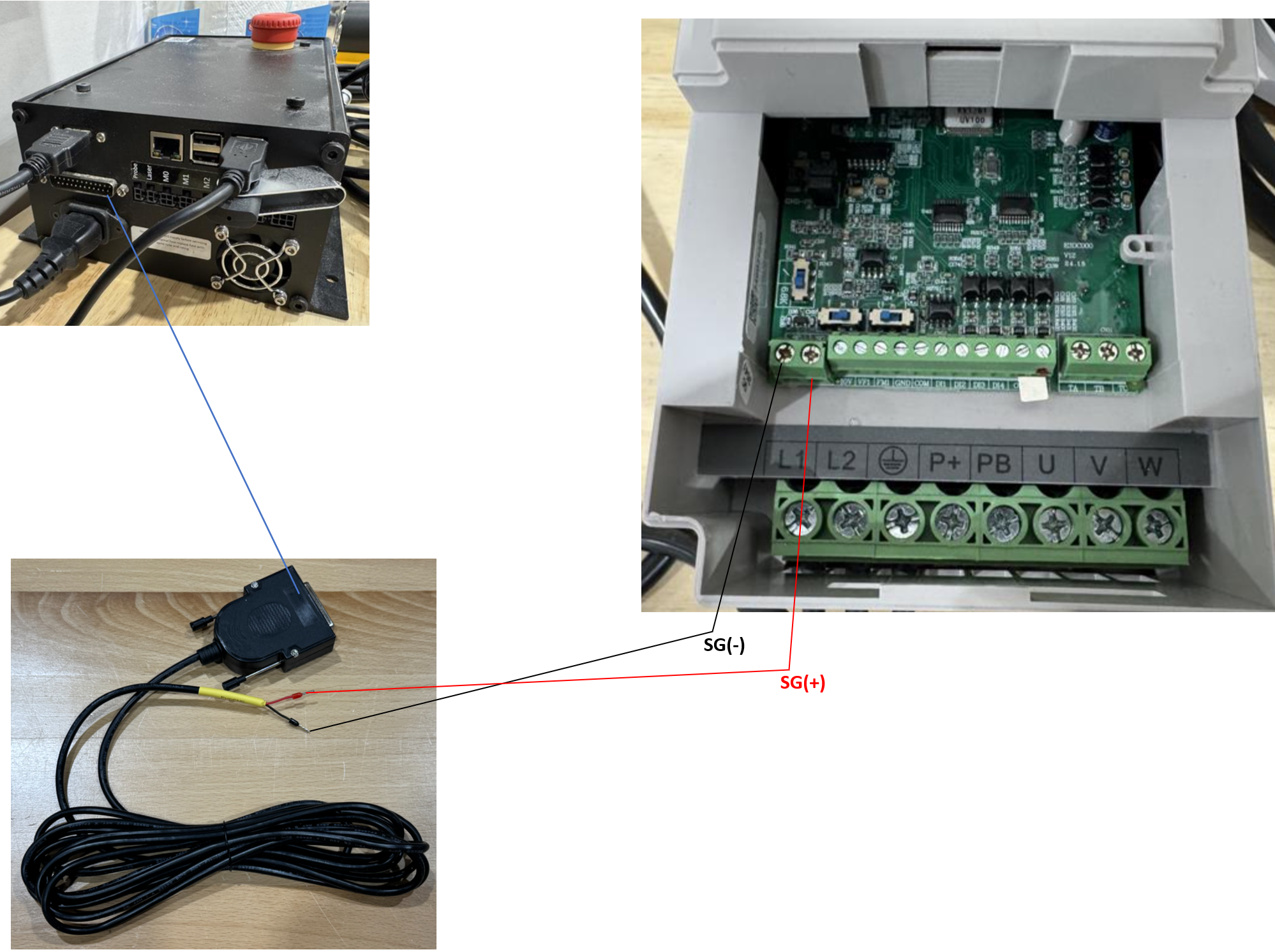

Wiring your Spindle to the Blackbox/BuildBotics-Clone Controller for Automatic Mode Operation
Spindle System Wiring
Spindle Kit Wiring
This mode is where your CNC controller controls the VFD via Modbus/RS-485 communications connection signal.  For Blackbox/BuildBotics-Clone, your controller is able to control CW/Forward, CCW/Reverse, and the 0-24000rpms.
We have pre-programmed your VFD to run in automatic mode when the Manual Override switch is flipped to automatic (down or 0 position).  The vfd will digitally communicate with your Blackbox/BuildBotics-Clone Controller over Modbus, also known as RS-485, for telling the spindle how fast it should spin and in which direction.  When your controller tells the spindle to stop moving... the VFD's will be in standby/stopped mode with a blinking keypad display.  When your controller tells the spindle to run at a certain speed, your VFD will be changed to spin/forward mode with a solid keypad display showing the RPMs it was told to spin the motor at.
P0.0.03 = 2
P0.0.04 = 9
Your VFD will now perform two-way communications with the Blackbox/BuildBotics-Clone controller.  The controller now uses the Modbus/RS-485 wires to know how fast it should spin the motor as well as when to switch from Stopped/Standby to CW/Forward to CCW-Reverse.
When your VFD is told to switch from Run Mode the vfd will change from standby/stopped mode (blinking keypad display) to spin/forward mode (solid keypad display).
In Run Mode, the VFD will also spin the the commanded RPMs which will be displayed on the VFD's keypad.

4. Validate the VFD Settings. To do this press “mode” on the keypad. P0.0.00 should be blinking. Use the double arrow button to navigate to the next segment, and the up and down arrow to change the parameter. Once you’re on the correct one, press enter button, and again up or down to change the selection, and enter to accept it: (There is flow chart of how to navigate here)
  • P0.0.03 should be 2
  • P0.0.04 should be 9
5. Try removing the standoffs at the connection of the receiving end of the DB25 connector.
6. If you're showing "Timed Out", swap the cables in the breakout board. The wiring is sometimes backwards in the controller, and if you switch the cables in pin 13 & pin 14 it will make the proper connection. If this does not resolve the connection problem, swap them back.
