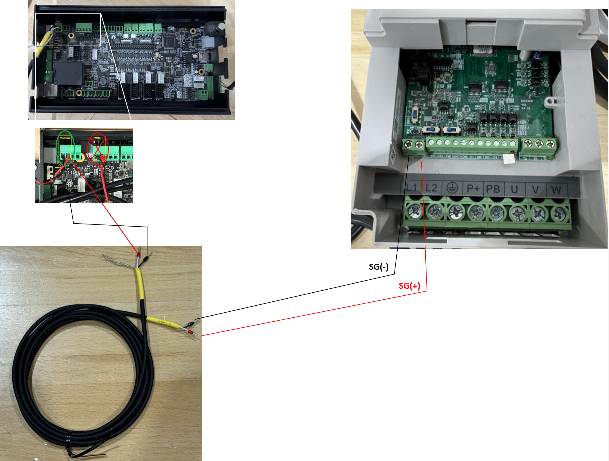

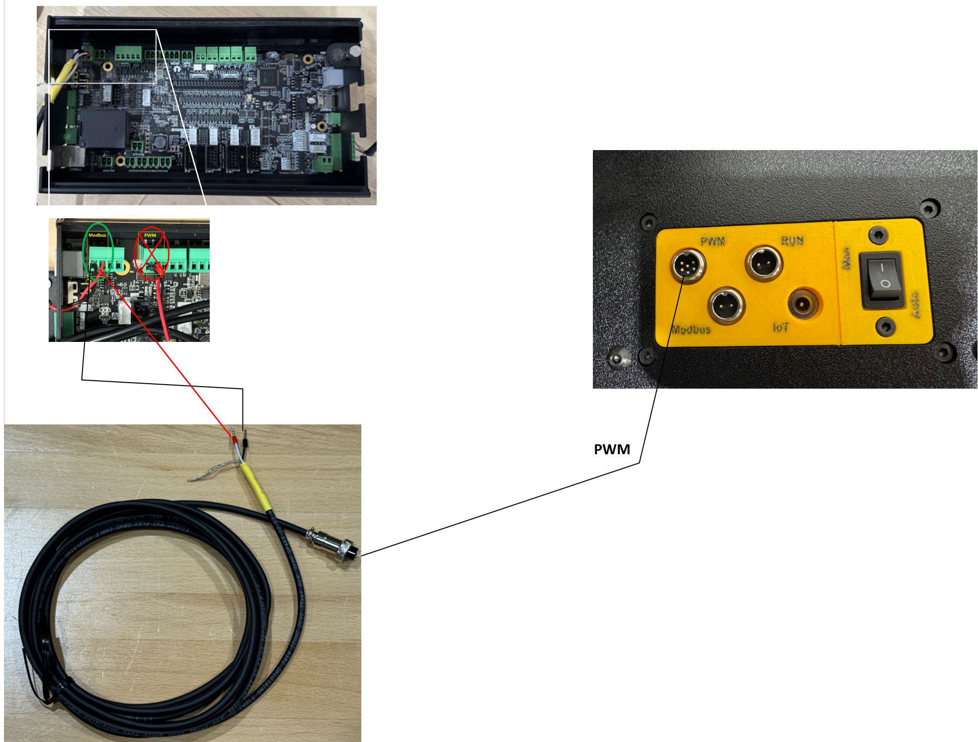

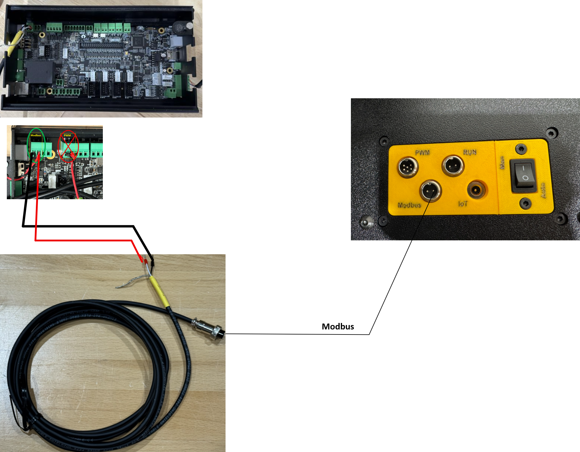

Wiring your Spindle to the SuperLongBoard(-ext) Controller for Automatic Mode Operation
Spindle System Wiring
Spindle Kit Wiring
This mode is where your CNC controller controls the VFD via Modbus/RS-485 communications connection signal.  For SuperLongBoard(-ext), your controller is able to control CW/Forward, CCW/Reverse, and the 0-24000rpms.
We have pre-programmed your VFD to run in automatic mode when the Manual Override switch is flipped to automatic (down or 0 position).  The vfd will digitally communicate with your SuperLongBoard(-ext) Controller over Modbus, also known as RS-485, for telling the spindle how fast it should spin and in which direction.  When your controller tells the spindle to stop moving... the VFD's will be in standby/stopped mode with a blinking keypad display.  When your controller tells the spindle to run at a certain speed, your VFD will be changed to spin/forward mode with a solid keypad display showing the RPMs it was told to spin the motor at.
P0.0.03 = 2
P0.0.04 = 9
P0.0.11 = 6
P2.0.02 = 21
P4.1.00 = 4
P4.1.01 = 3
Your VFD will now perform two-way communications with the SuperLongBoard(-ext) controller.  The controller now uses the Modbus/RS-485 wires to know how fast it should spin the motor as well as when to switch from Stopped/Standby to CW/Forward to CCW-Reverse.
When your VFD is told to switch from Run Mode the vfd will change from standby/stopped mode (blinking keypad display) to spin/forward mode (solid keypad display).
In Run Mode, the VFD will also spin the the commanded RPMs which will be displayed on the VFD's keypad.

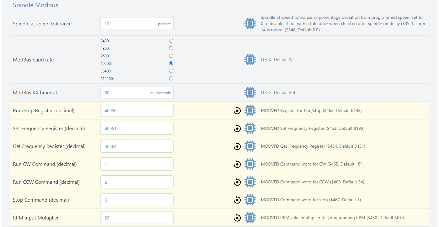

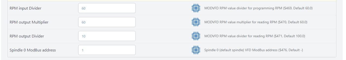

CONFIGURING gSender (grblHAL Modbus)
Modbus requires correct firmware configuration.
We strongly recommend exporting your current settings before making changes:
gSender → Config → Export
This will produce a .json file with your settings inside.
Known Working grblHAL Settings
The following values must match exactly:
$16 = 0
$30 = 24000
$31 = 6000
$340 = 0
$374 = 19200
$375 = 50
$392 = 10
$395 = MODVFD
$462 = 40960
$463 = 40961
$464 = 36864
$465 = 1
$466 = 2
$467 = 6
$468 = 25
$471=10
$476 = 1
If $476 is unavailable, check neighboring parameter $478 for spindle address.
Baud rate must match between VFD and grblHAL.
If any value differs, correct it and reboot the controller.
