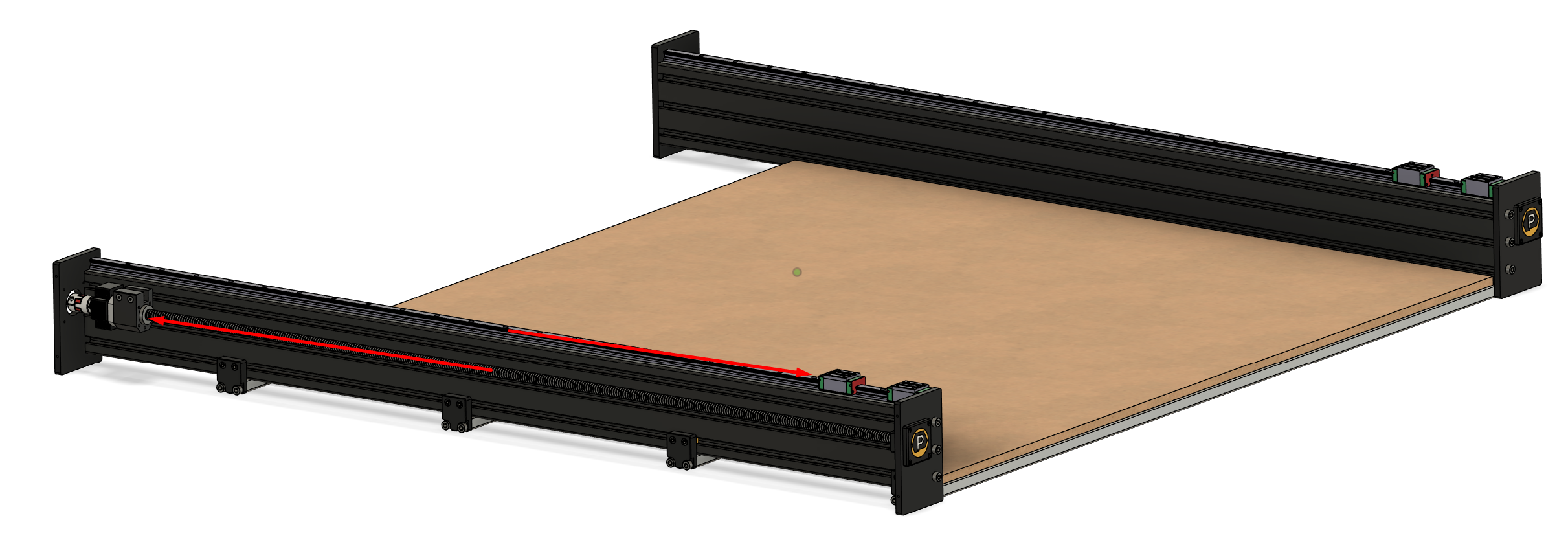

Ahead of placing your gantry into position, manually slide both Y Carriage Nuts to the rear of the machine.
Also move the X linear rail carriages all the way to the front as shown in the next image.

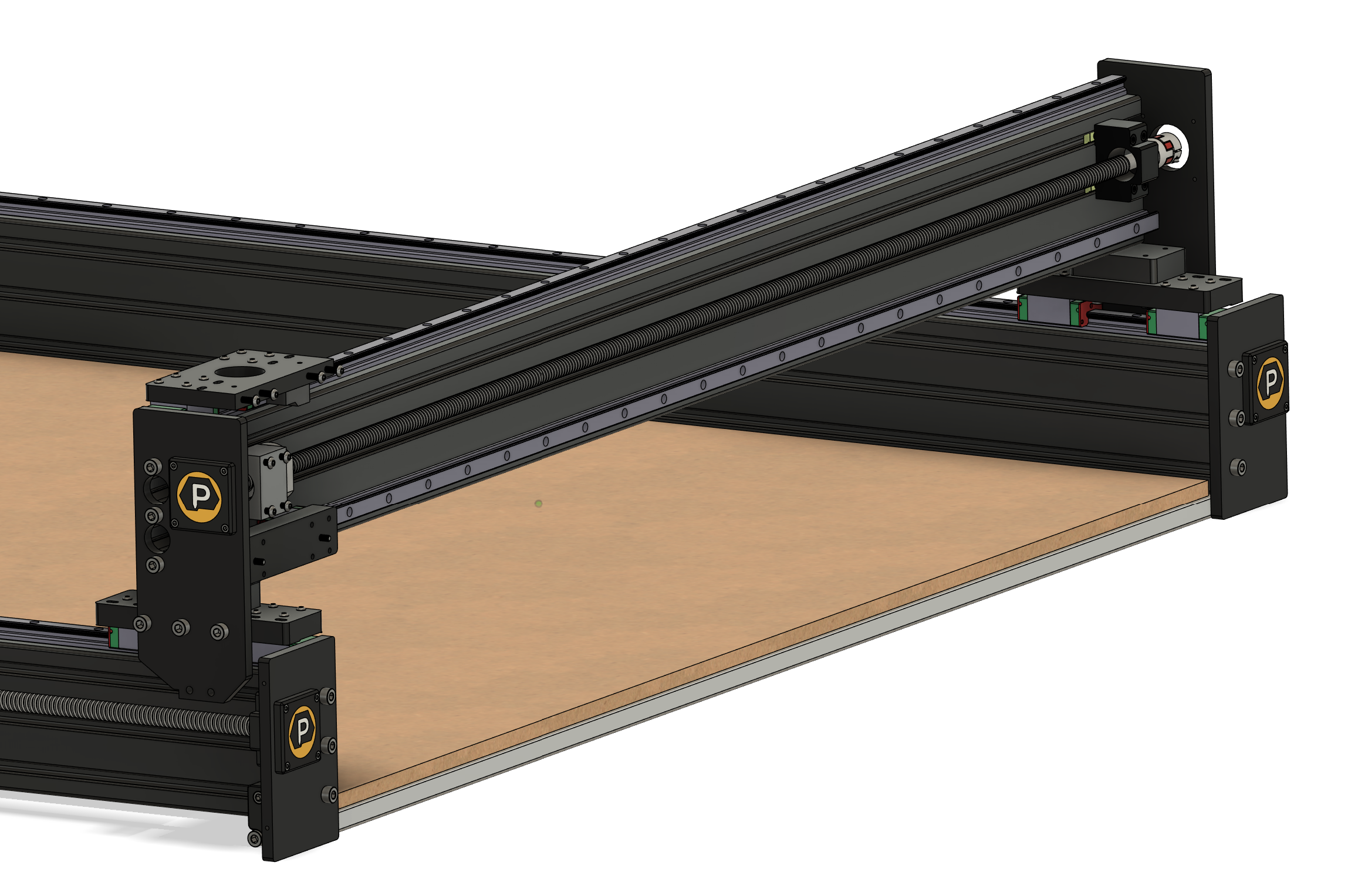

Place the gantry on top of the linear carriages:
Use the (16) M4 Button-head screws to loosely secure the carriage onto your machine assembly.
