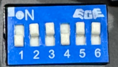

On the side of each motor you’ll find a DIP switch chart printed on the housing.
  • SW1–SW4: Set the encoder PPR value
  • SW6: Inverts motor direction at the hardware level
The PPR switches must match the encoder configuration in the controller. The direction switch should normally remain OFF, with direction handled in
software.

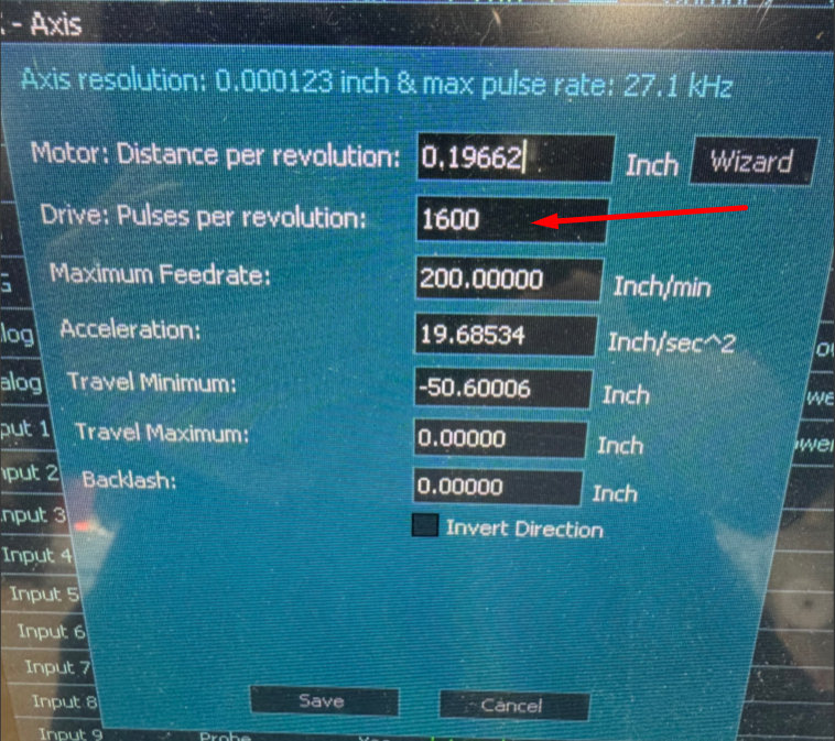

1600 Pulses per Revolution (Recommended)
This is the default and recommended setting for nearly all PwnCNC conversion kits.
Why we recommend it:
  • Stable and reliable
  • Lower signal frequency
  • More tolerant of EMI and long cable runs
  • Plenty of resolution for woodworking, plastics, and light metal work
This setting is what we test, ship, and support by default.

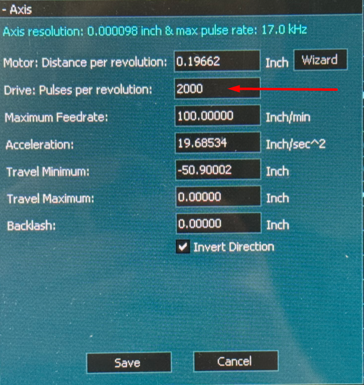

2000 Pulses per Revolution (Advanced Use Only)
This provides slightly finer feedback resolution, but comes with tradeoffs.
Consider 2000 PPR only if:
  • You understand encoder frequency limits
  • Your machine is mechanically rigid
  • Your grounding and shielding are excellent
  • You are chasing very fine motion smoothness in metal work
Higher PPR does not increase torque or accuracy by itself. It only refines feedback.
