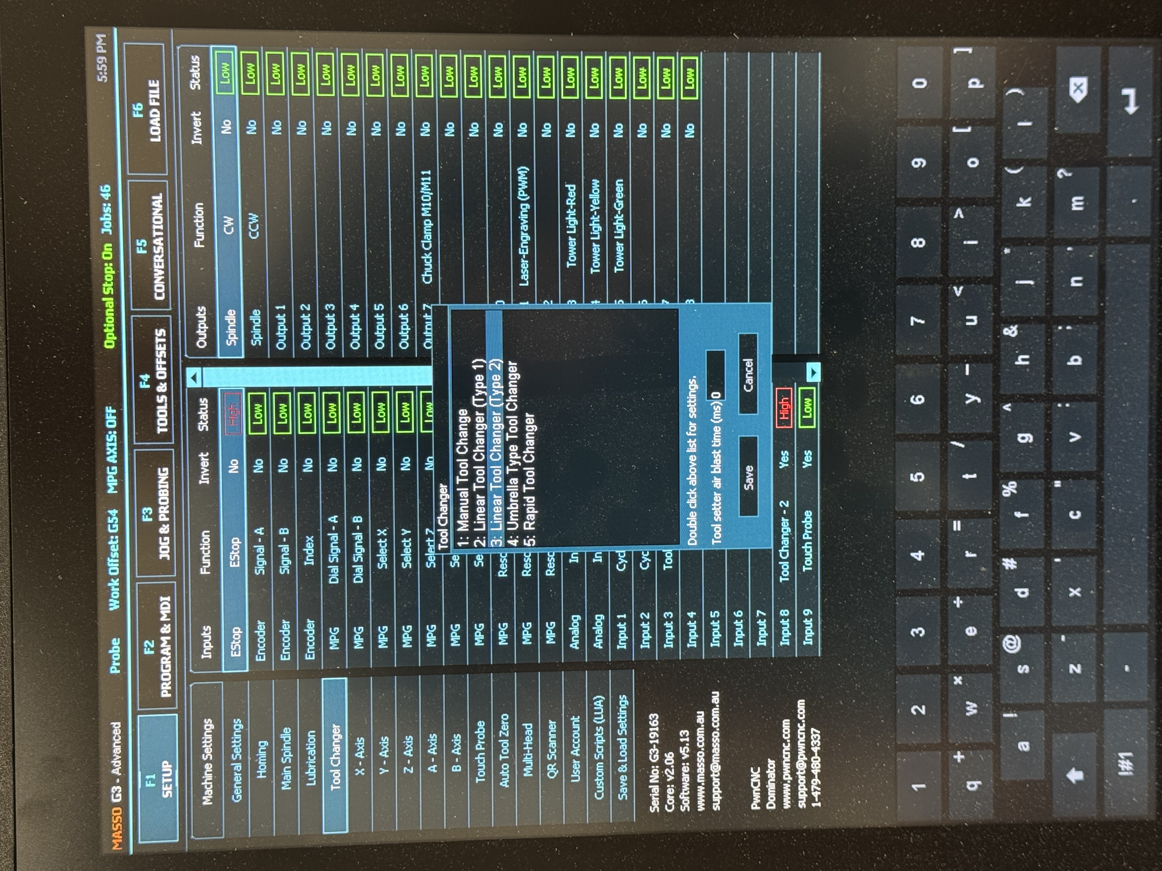

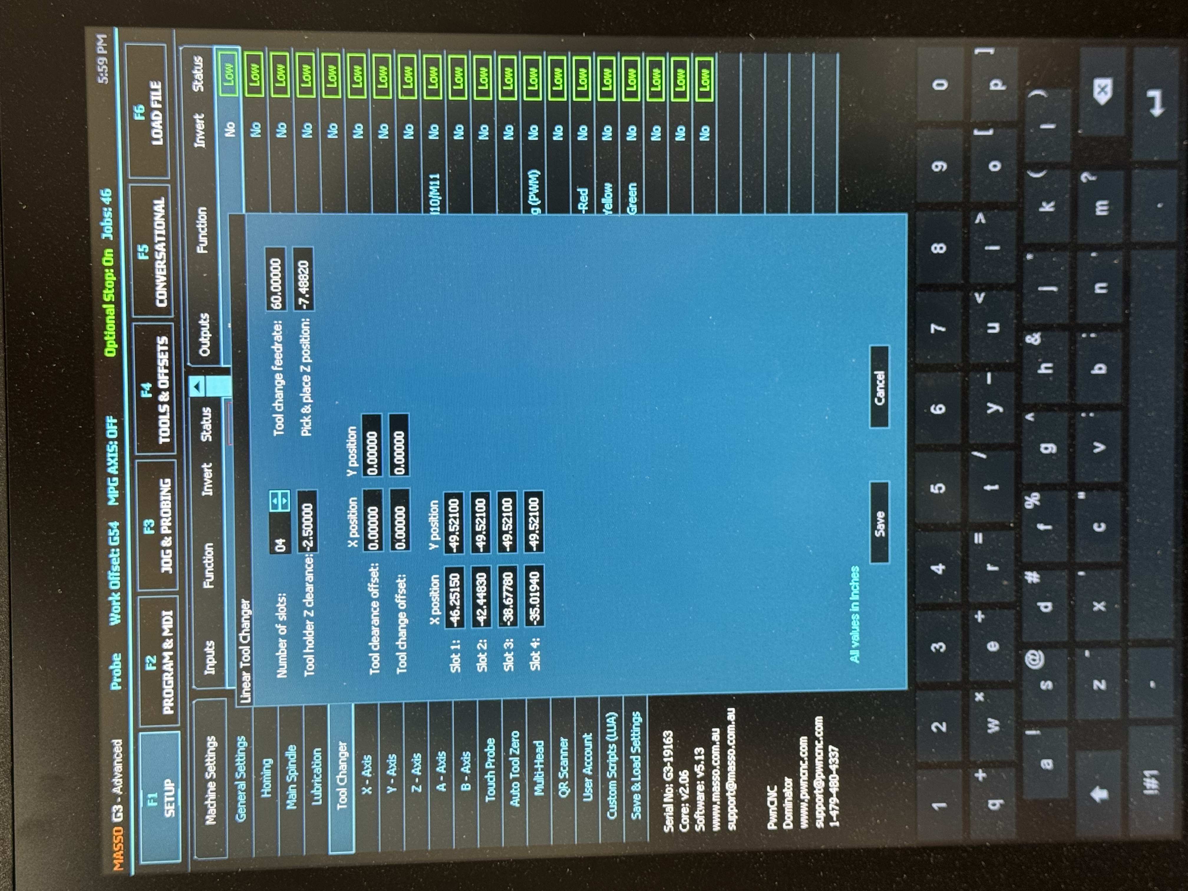

Note that I am using 4 tool-cups mounted in the front-left of my machine.  I'm using a statically mounted PwnBoot which does not move during the tool-changing operation.  This means tool-cups must be tall enough and spread out enough as to not interfere with the boot.
