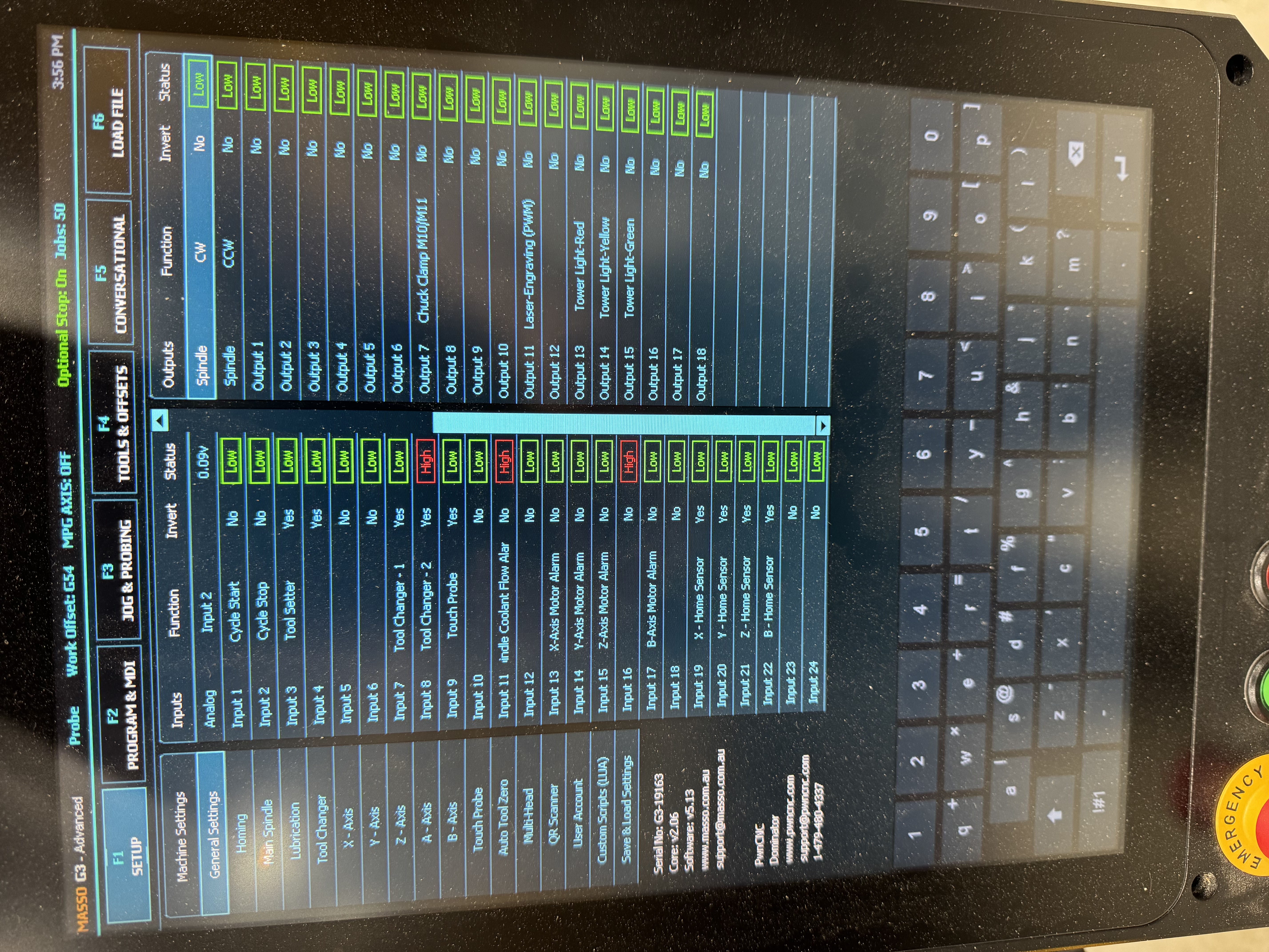

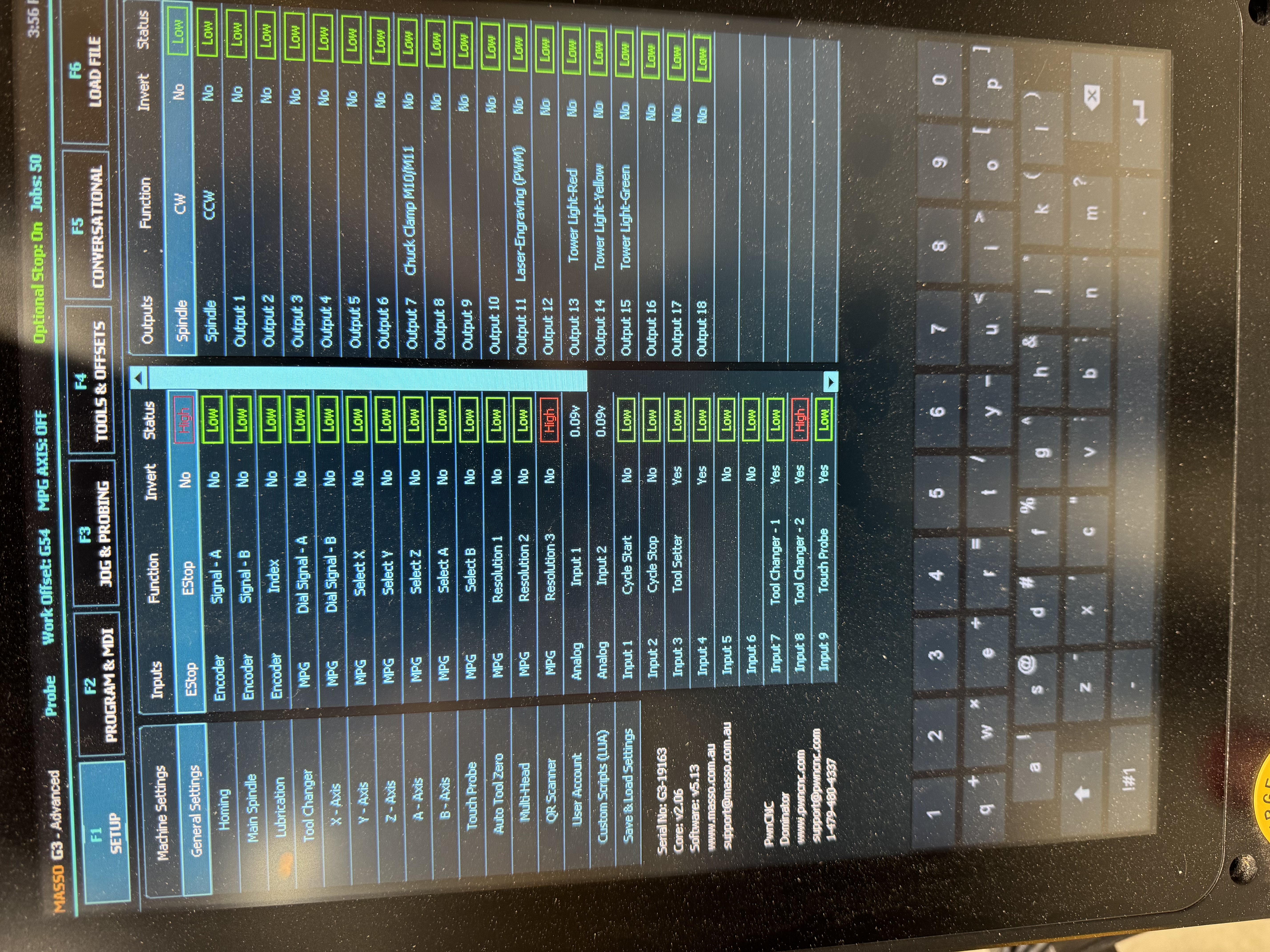

F1 - General Settings
Note that you may have your sensors wired into different inputs than I do here.  The primary thing to glean from this is the inverted status and the exact function assigned.
