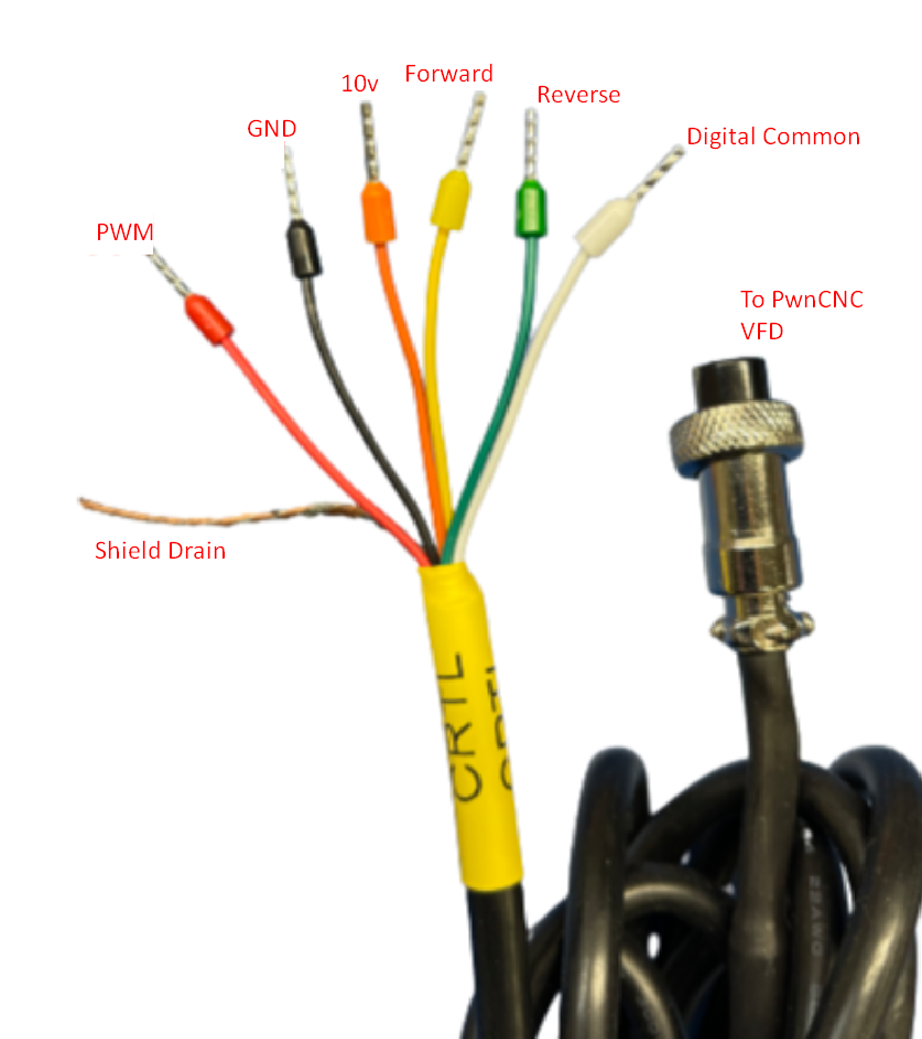

We've only done research thus far on this controller so no one has confirmed this information beyond their controller manual info.
Their controller runs 0-10v PWM signal and should be wired as follows:
Red -> Connector 7 Pin 1 on Nighthawk
Black -> Connector 7 Pin 4
Yellow -> Connector 7 Pin 2 (CW/FOR)
Green -> Connector 7 Pin 3 (CCW/REV)
White -> Connector 7 Pin 4
