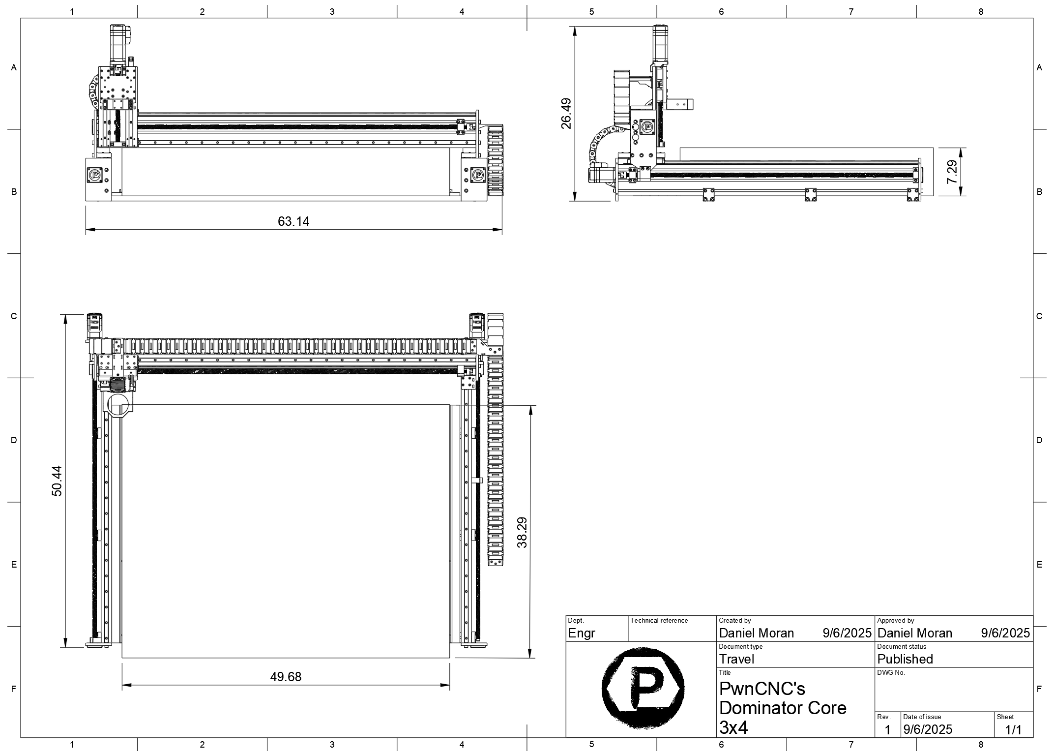

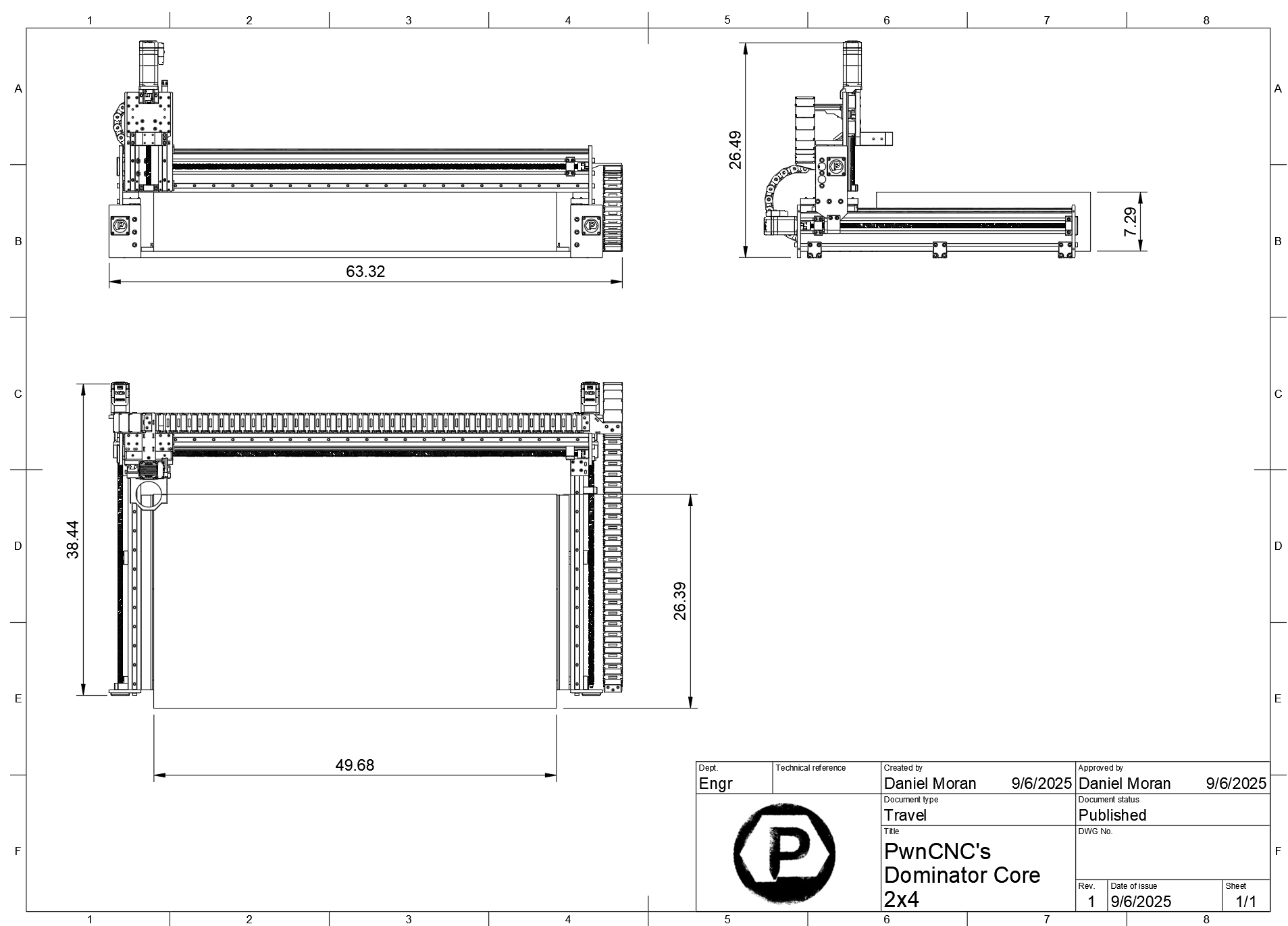

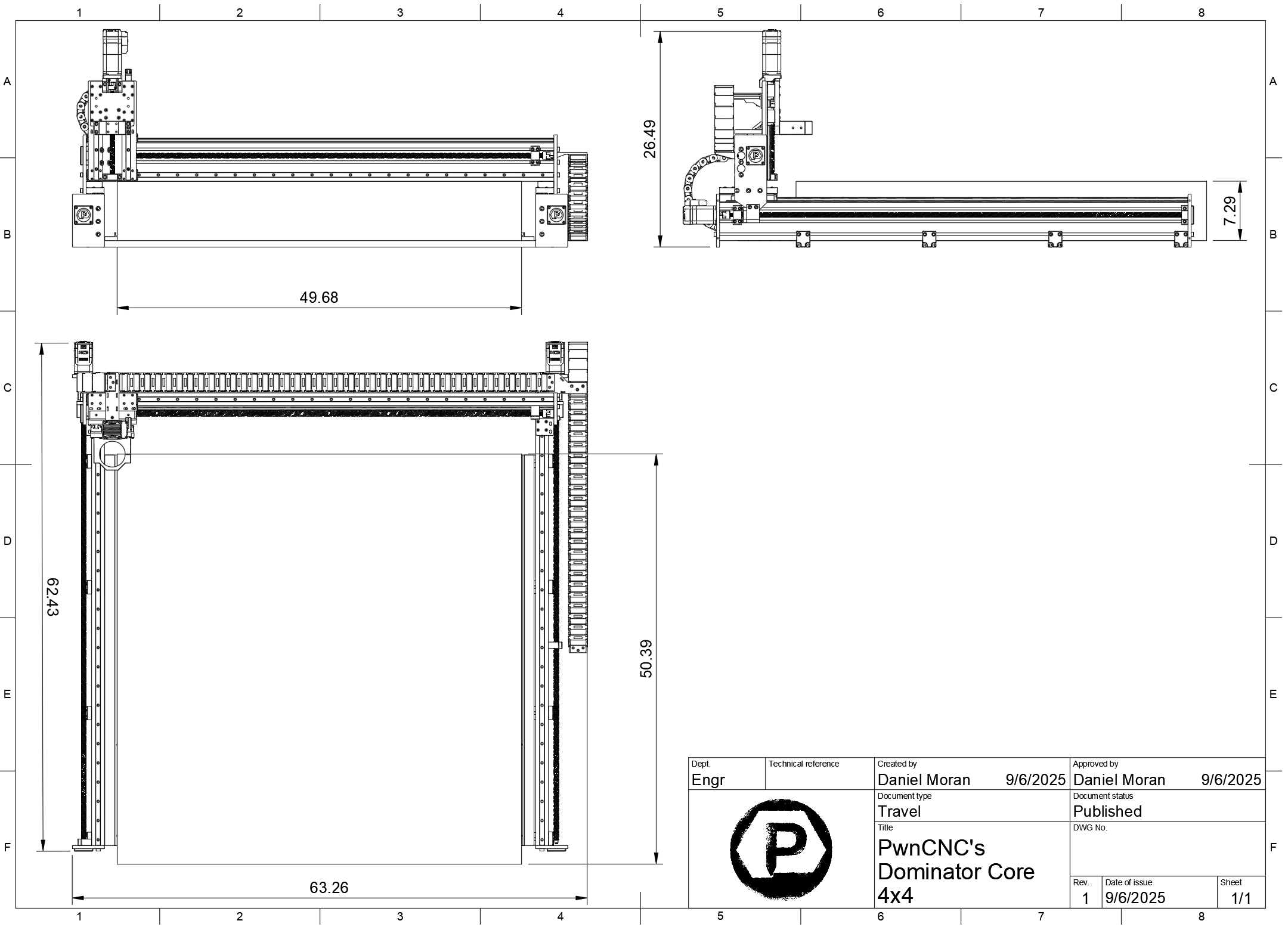

Dominator Core - Dimensions

Dominator_Core_2x4_Drawing.pdf Dominator_Core_3x4_Drawing.pdf Dominator_Core_4x4_Drawing.pdf
