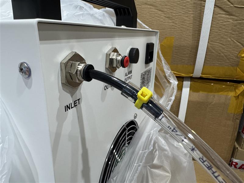

Our suppler doesn't seem to be consistent with the connectors on the chillers we receive.

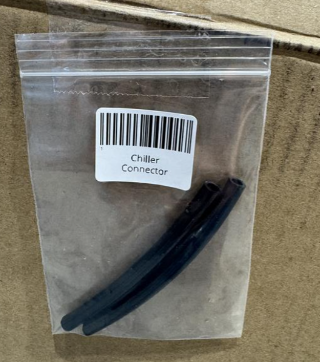

Occasionally we need to solve this with minor kits we include with each chiller to ensure connection to our tubing.
If your chiller has press-in fittings, we've included short tubes that can be used to bridge the gap between those press-in tubes and the clear tubes for your spindle.
