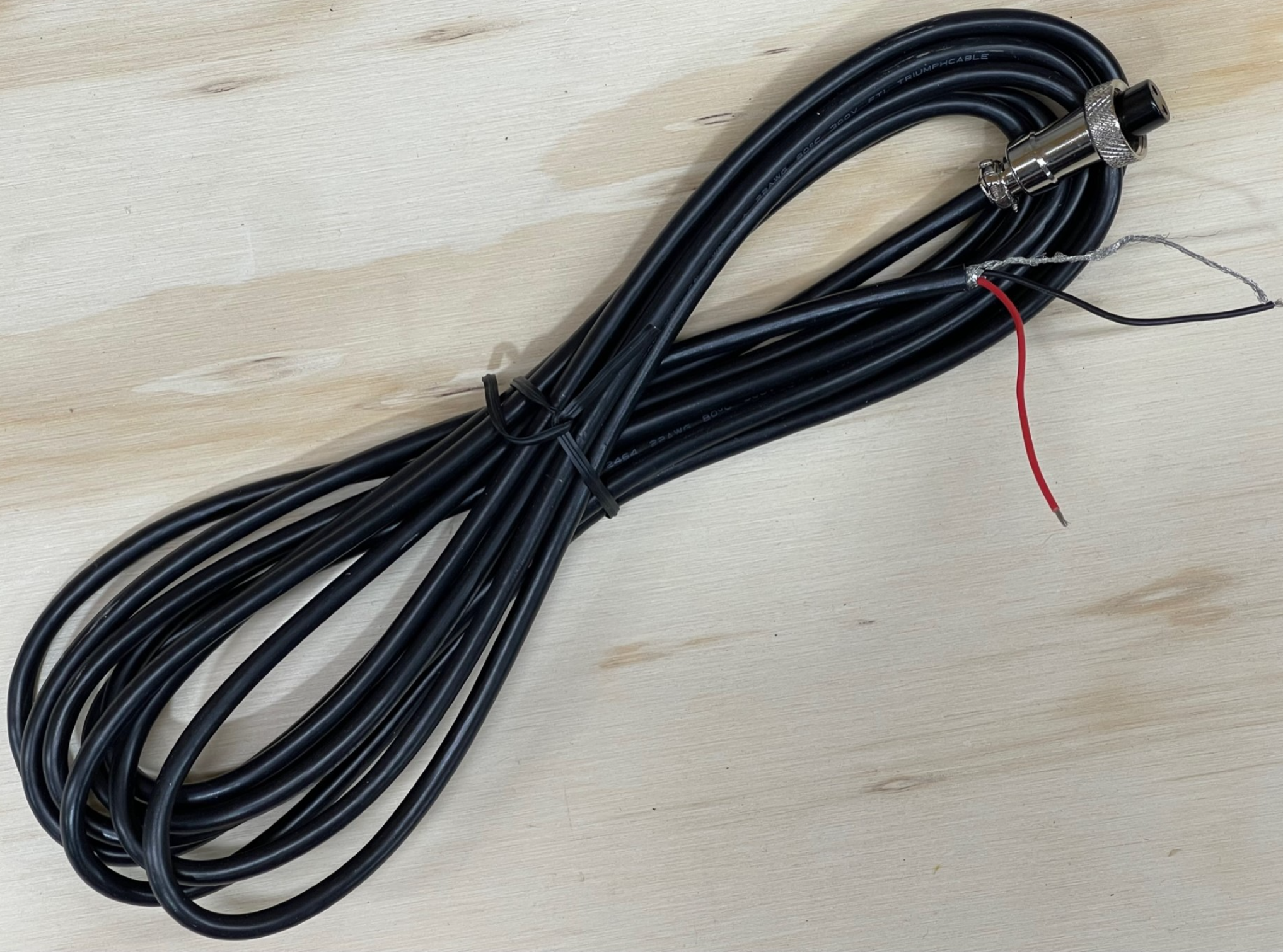

GX12 2-pin aircraft connector on one side
Loose wires on the other with shielding cut back

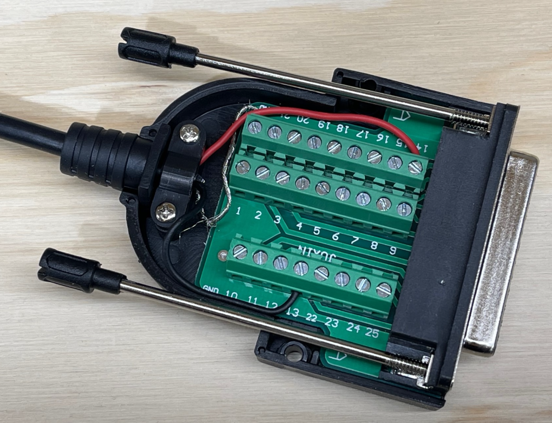

We will add the DB25 breakout board in-house.
Black wire to pin 14
Red wire to pin 13
Shield drain to GND
